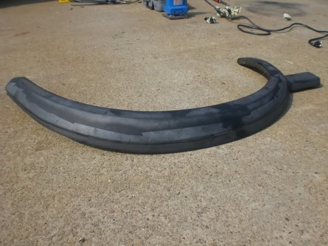

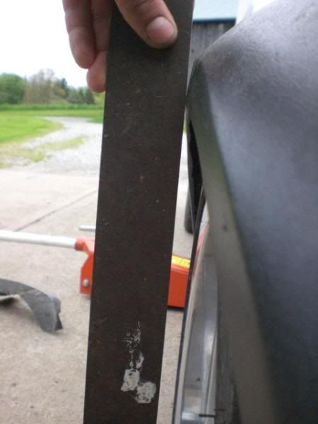

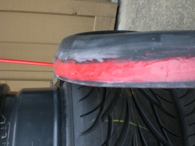

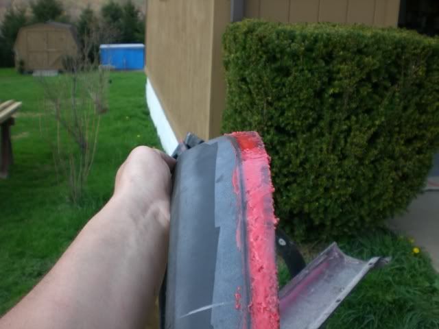

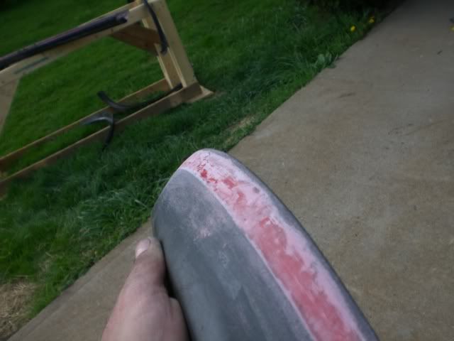

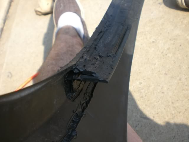

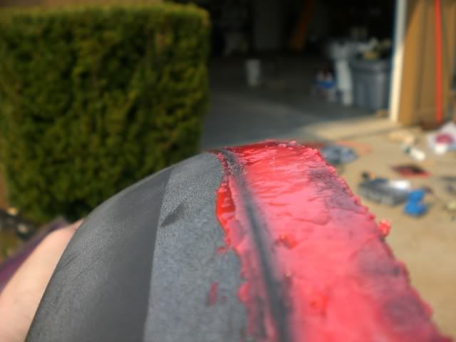

UPDATE :
started on my "custom" front flares today :
take 2 passenger side fronts, 1 with trim piece, one without trim piece. over lay the one on the other:
trim and plastic weld the **** outta them:
check out the difference in width. from 1" to 2.25":
slap some fusor on em:
sand a lil:
slap another coat on :
more to come=>

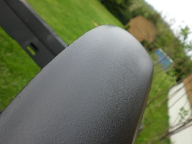

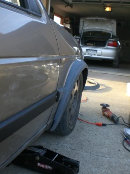

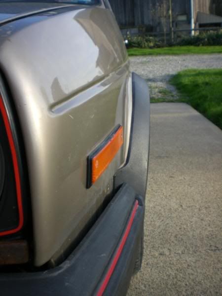

UPDATE2 :
finished painting the other caliper finally, just need to finish rebuilding it tomorrow. need to install the new seals, pistons, dust boots, & bleeder.
test fitted the flare, it looks wicked :
they are atleast .75" wider than 8v big bumper flares. i betcha they are as wide, if not wider than 16vG60 flares
and for a comparison :
vs

Много ми е интересно с какво ги е пръскал,прилича на шагрена на Боди.
Последните които видях бяха стигнали към 300 паунда на наддаване.Ще ме извините готини са ма 600 лева и за 4 пласмаси а нема нужда :deal
