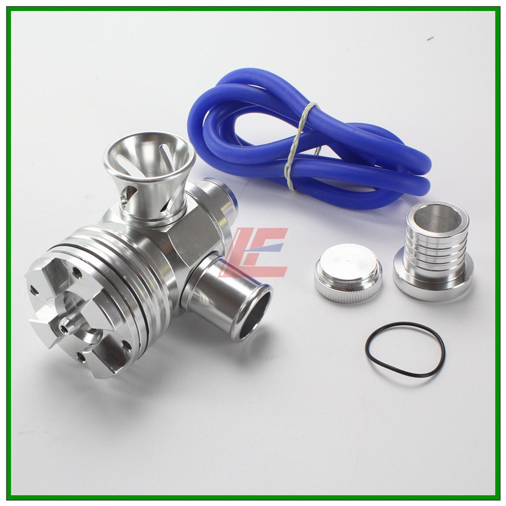

Аз смятам да си взема такъв - кеф ти блоу офф,кеф ти рециркулация,кеф ти и двете заедно.Излиза около 100лв от ebay.Някой има ли наблюдения над този клапан?
Description:
This Splitter Hybrid Diverted Adjustable Valve (aka; Blow Off Valve) is for ALL :
Volkswagen 1.8T Engines
Audi 1.8T Engines
Volkswagen 2.7L Bi-turbo Engines (Requires 2x BOV per car for the 2.7L motors)
Audi 2.7L Bi-turbo Engines (Requires 2x BOV's per car for the 2.7L motors)
This is designed specifically for all the Volkswagen / Audi 1.8T and the 2.7L engines. Made out of aircraft super strong and light weight Aluminum 6061. Will also work on other cars measuring at 25mm (.986 of an inch) inlet and out if you want it re-circulating. This is available in Anodized BLACK or Machined SILVER (Silver is in our other ebay listing). The piston internal is made out of Copper/ Zinc Plated.
Precise Adjustment of the Splitter Hybrid Valve is done by turning the ratchet type cap adjustment knob located on the top of the valve. Turning the knob clockwise will stiffen the spring for higher levels of boost retention, while turning the knob counter-clockwise will loosen the spring tension for lower levels of boost retention.
The Hyrbid Valve is capable of 3 different setups, which are:
1.) Hybrid: Atmospheric AND Re -circulating Operation
2.) 100% Re-Circulating Mode
3.) 100% Atmospheric Mode
