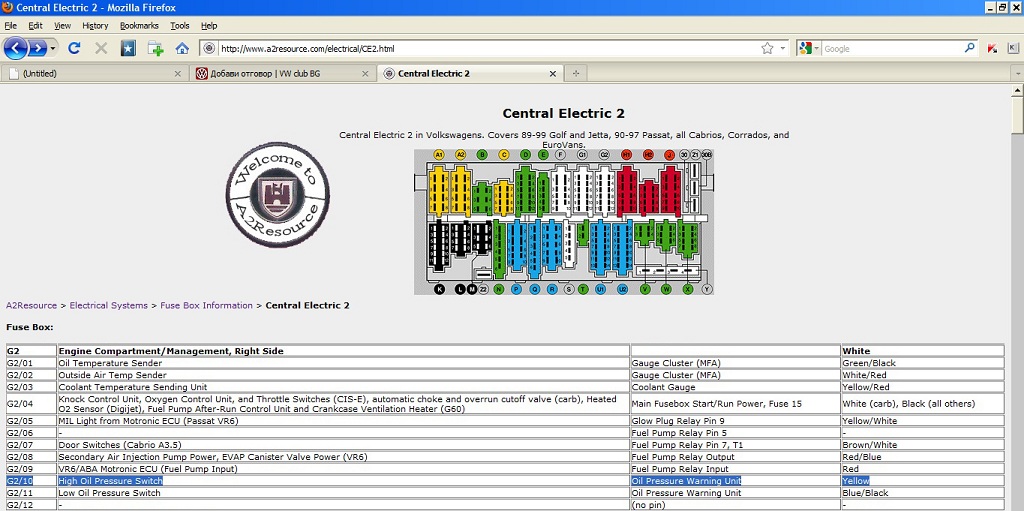

http://www.a2resource.com/electrical/CE2cluster.html
От сините букси към таблото
T28/08 High Oil Pressure Signal U1/03 Yellow Yellow Yellow White White
T28/09 Low Oil pressure Signal U1/05 Red/White Red/White Red/White White White
http://www.a2resource.com/electrical/CE2.html
От датчиците до бушониерата
G2/10 High Oil Pressure Switch Oil Pressure Warning Unit Yellow
G2/11 Low Oil Pressure Switch Oil Pressure Warning Unit Blue/Black
