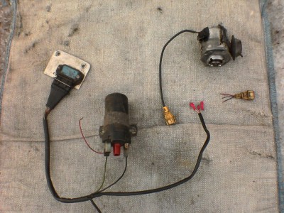

Here is a pic of the Peugeot distributor setup which is a straight fit on the VW 1.8 and 2.0 16v engines.
It uses the VW carb ignition loom from either a 1.6 / 1.8, or the smaller 1.1 / 1.3 engines that use the TCI electronic ignition system.
The ignition module (top left) needs to be changed for the Peugeot one as the dizzy uses a different operating principle from the VW type.
Wiring wise, the black wire disappearing out of shot in the lower centre of the pic is the earth connection that goes to the battery negative. It is actually a brown wire in a black sleeve.
The coil wires stay as normal, ie. On the left of the coil are the green wire and the red / black trace wire which connect to the coil negative terminal. The red / black trace wire is the rev counter signal and there will be a red / black trace wire in the existing engine bay loom.
Then on the right of the coil there is the black wire which connects to the coil positive terminal. There will be another black wire in your existing engine bay loom that also connects to the coil positive and supplies 12v when the ignition is switched on.
This leaves the wires to the distributor that need altering to allow the Peugeot dizzy lead to connect to the VW loom. There are 3 wires, one is a screen. These connect by cutting off the white connector on the Pug dizzy lead then joining as follows.
Brown / white trace on the VW loom, connects to the copper screen on Pug dizzy lead.
Green / white trace on VW loom, connects to red on Pug dizzy lead.
Red / black trace on VW loom, connects to black on Pug dizzy lead.
I use different terminals for these three wire connections so I can just plug another dizzy in without having to remember which wire went where.
There are a several differenet types of dizzy cap for the Pug. Spring clip and screw fitting cap, and also pin or socket HT lead connections. You will need the socket type HT connections for the VW HT leads and whatever type of cap location suits your dizzy.
This is for the Bosch dizzy. There are other types that do not work with this setup so be careful when sourcing parts. Bosch dizzy and the blue coloured ignition module are what you are after.

ivo_asenov написа:Here is a pic of the Peugeot distributor setup which is a straight fit on the VW 1.8 and 2.0 16v engines.
