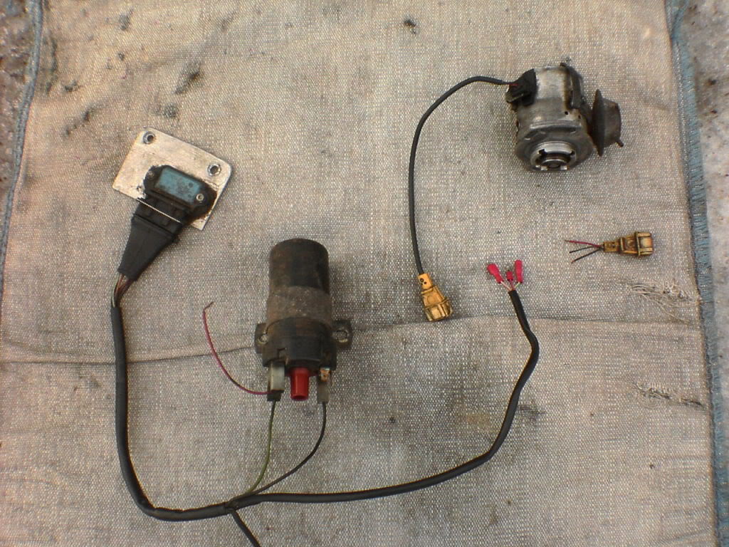

Here is a pic of the Peugeot distributor setup which is a straight fit on the VW 1.8 and 2.0 16v engines.
It uses the VW carb ignition loom from either a 1.6 / 1.8, or the smaller 1.1 / 1.3 engines that use the TCI electronic ignition system.
The ignition module (top left) needs to be changed for the Peugeot one as the dizzy uses a different operating principle from the VW type.
Wiring wise, the black wire disappearing out of shot in the lower centre of the pic is the earth connection that goes to the battery negative. It is actually a brown wire in a black sleeve.
The coil wires stay as normal, ie. On the left of the coil are the green wire and the red / black trace wire which connect to the coil negative terminal. The red / black trace wire is the rev counter signal and there will be a red / black trace wire in the existing engine bay loom.
Then on the right of the coil there is the black wire which connects to the coil positive terminal. There will be another black wire in your existing engine bay loom that also connects to the coil positive and supplies 12v when the ignition is switched on.
This leaves the wires to the distributor that need altering to allow the Peugeot dizzy lead to connect to the VW loom. There are 3 wires, one is a screen. These connect by cutting off the white connector on the Pug dizzy lead then joining as follows.
Brown / white trace on the VW loom, connects to the copper screen on Pug dizzy lead.
Green / white trace on VW loom, connects to red on Pug dizzy lead.
Red / black trace on VW loom, connects to black on Pug dizzy lead.
I use different terminals for these three wire connections so I can just plug another dizzy in without having to remember which wire went where.
There are a several differenet types of dizzy cap for the Pug. Spring clip and screw fitting cap, and also pin or socket HT lead connections. You will need the socket type HT connections for the VW HT leads and whatever type of cap location suits your dizzy.
This is for the Bosch dizzy. There are other types that do not work with this setup so be careful when sourcing parts. Bosch dizzy and the blue coloured ignition module are what you are after.

Той използва въглехидрати VW запалване стан или от 1.6 / 1.8, или по-малките 1.1 / 1.3 двигатели, които използват TCI система за електронно запалване.
За запалване модул (горе вляво) трябва да се промени за един Peugeot като замаяни използва друг принцип, които оперират от типа VW.
Окабеляване мъдър, черният проводник изчезват от изстрел в долния център на своя земя е връзка, която отива в батерията отрицателни. Това всъщност е кафяв проводник в черен ръкав.
Бобина кабели престой, както обикновено, т.е.. От ляво на бобината са на зелена тел и червено / черно следи от тел, която се свърже с намотка отрицателния полюс. В червена / черна следа проводник е на оборотомера сигнал и ще има червени / черни следи тел в съществуващите залив двигател стан.
След това в правото на антената там е черна жица, която се свързва с намотка плюс. Няма да има друга черна тел в съществуващата двигателния отсек стан, които също се свързва със серпентина положителни и доставки 12v, когато запалването е включено.
Това оставя тел на дистрибутора, които трябва да се позволи промяна на Peugeot замаяни доведе да се свърже с VW стан. Има 3 кабела, един е на екран. Те се свържете с прекъсване на бял конектор на замаяни Мопс доведе след присъединяването, както следва.
Браун / бели следи на VW стан, се свързва с меден екран на Мопс замаяни олово.
Зелени / бели следи на VW стан, се свързва с червено Мопс замаяни олово.
Червено / черно следа на VW стан, се свързва с черен цвят на Мопс замаяни олово.
Използвам различни терминали за тези три метални връзки, така че може просто да включите в друг замаяни, без да се налага да помните, който беше там, където тел.
Има няколко вида differenet на замаяни капачка за Мопс. Пролет клип и винт монтаж шапка, а също и щифт или гнездо връзки водят HT. Вие ще трябва контакта връзки тип HT за VW HT води и независимо от вида на костюми капачка местоположението си замаян.
Това е за световъртеж Бош. Има и други видове, които не работят с тази настройка, така че бъдете внимателни при източника части. Bosch замаяни и оцветени в синьо модул запалване са това, което търсите.

ivo_asenov написа:Here is a pic of the Peugeot distributor setup which is a straight fit on the VW 1.8 and 2.0 16v engines.
