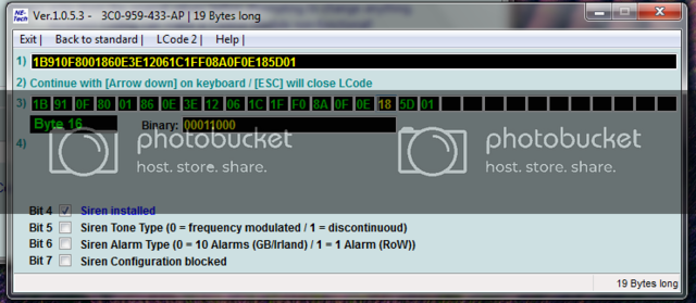

krraynov написа:Не не успях, за съжаление.
Колега ,това намерих,ако още ти е необходимо -
Pin 1 – LIN cable going to convenience module inside cabin behind glove box - 6 pin connector/PIN 6
Pin 2 – Ground – there is nice ground point by water tank
Pin 3 – Power going to fuse box inside cabin -> fuse #14 / 10Amp.
