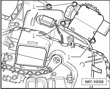

Removing and installing centre flap control motor -V70- or front air distribution flap control motor -V426-
Removing
Remove dash panel → General body repairs, interior; Rep. gr.70; Dash panel: Removing and installing dash panel.
– Disconnect connector from front air distribution flap control motor -V426- or centre flap control motor -V70-.
Note
The centre flap control motor -V70- / front air distribution flap control motor -V426- is located on the left of the heater and air conditioning unit.
– Remove securing bolts -1- and remove control motor.
Installing
Install in reverse order.
Note
t After installing centre flap control motor -V70- or front air distribution flap control motor -V426-, check operation of flap.
t Initiate “basic setting” function using vehicle diagnostic tester.
