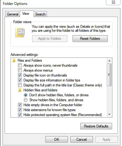

Проблема не е в носителя, а в това че виндовса се опитва да направи........
Цитат: The reason for the crashes are the thumbnails. These tend to happen with generating thumbnails for .mkv and a few other files. To solve this problem:
1. Open Windows Explorer. (Could be anything. Documents, Computer, it doesn't matter)
2. On the top left is a drop-down button that says "Organize". Click on it.
3. Click on "Folder and search options".
4. Click on the "View" tab.
5. Uncheck "Always show icons, never thumbnails."
6. Click Ok
