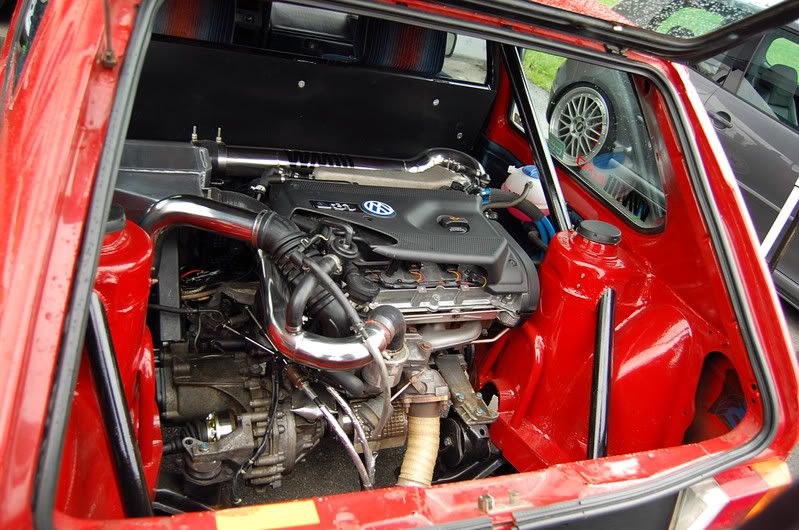

Ето инфо за тази "кола"
ето и снимките
А ето и какво причини тази кола на дино стенда
http://www.msplinks.com/MDFodHRwOi8vdHV ... AxLndtdg==
basic vehicle: VW Polo MkI
engine: VW 1.8l 16V (Turbo by AME)
power: 1047PS/770kW 950Nm at 7734rpm with 2.75bar boost
820PS at 2.1bar boost
1/4mile test so far driven with 2.1bar boost and 820hp 9.42s/245km/h
acceleration perfromance with 2.1bar boost
0-100km/h (62mph) 2.7s
0-200km/h (125mph) 7.0s
0-245km/h (153mph) 9.42s
shift rpm 9400rpm
topspeed 6.gear at 9000rpm over 300km/h
6speed tranny from Audi TT with quattro AWD and AWD lock
8 fuel injectors 650ccm at 3bar
adjustable fuel pressure up to 4.2bar
Garret GT 40 RS Turbo
exhust mainfold with push charge (dont know the correct word for Stoßaufladung)
AME High performance piston roads with improved connections 160mm
AME forged pistons 82.5mm
crankshaft 86.4mm lift
alu oil sump
improved cyl head with stronger valve springs and fixed overhead bucket tappet
different camshafts for intake and exhust valves
special build intake mainfold
alu 4 stage air intake system simmilar to Rally sport used or the one that Audi used in the US IMSA race series
free programmable CPU with AME Motronik 2.65
exhust system handbuild 76mm
intercooler water air
water methanol injection
clutch Sachs RS2 Sinta flywheel from VW G60
coiloverkit suspension
street tires 16" with 205/55 tires
race tires 15" rims with AVON slicks
etc.
weight including driver under 900kg(1980lbs)

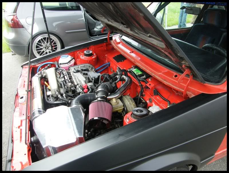

VW GOLF MK1 CABRIO
350HP by C.C.Racing dynojet
engine:1.8 8v g60 with turbo turbonetics super60, turbonetics external wastegate with turbonetics maniford, custom 3" stainless downpipe and exhaust system, Haltec engine management system,4 throttle body custom made 52mm with custom aluminium air box, evo6 550cc injectors, sachs sporting clutch with lightened flywheel, custom polished crankshaft and crank, custom pored and polished head, magnegor spark plug wires, external oil cooler,motorsport 6 speed gearbox with drug shift,evo3 intercooler with custom made stainless steel piping and HKS blowoff, BugPuck frond engine mount and custom rear mount, Samco blue sillicon hoses with stainless custom piping, TurboSmart two stage boost controller, Greddy turbo timer,
custom stainless water , breather, p/s tunks with Earls connectors and aeroquip hoses.
Chassis: 7.5x17inch rims with 215/40 Avon ZZR tyres,
Patec F1 adjustable coil over suspension kit, TAS adjustable top mounts,
imbreza carbon fibre strut brace upper and custom lower, Goodridge brake lines, Zimmermann cross drilled discs 280mm G60 front and 16v rear, Pagid-fast road pads, Powerflex suspension and anti-roll bushes and fited power steering.
