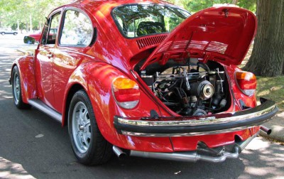

Пълна спецификация на купе и двигател . Костенурката е печелила куп награди, а моторът е от порядъка на 150+ кончета.
ПС. Нямам време да превеждам - ако някой го интересува нещо конретно да пита.

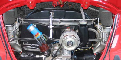

Engine Specs: Type 1, 2180cc, horizontally-opposed 4 cyl, balanced
Builder - Art Thraen
Compression Ratio - 9.5:1 (92x82, 56cc head, .057" deck)
Case - Volkswagen, AS41 (German), dual releaf, 8mm studs, case saver inserts, deep #3 studs, tapped for full flow oil system, stress relieved, deburred, blue printed
Crankshaft - 4340 Forged Chromoly, 82mm, forged, counterweighted, balanced, nitrided, 8 dowel (11/32"), stress relieved, shot peened, wedge mated, Buick journals
Connecting Rods - CB Performance H Beam, 5.4", ARP 2000 bolts, magnafluxed, balanced, Clevite 77 rod bearings
Pistons/Cylinders - AA, 92mm, Thick Wall, forged pistons, balanced
Camshaft - Engle FK-8, 298° duration / .382" lift (.535" with rockers)
Heads - Steve Tims, Stage 2, 42x37.5, ported, polished, 56cc chambers
Valves - Stainless steel, 42mm intake, 37.5mm exhaust, tappered guides
Rocker Arms - CB Performance 1.4 ratio, forged, needle bearings, heavy duty studs
Valve Train - Manton dual springs, Manton 3/8" chromoly push rods, Chromoly retainers, Wizemann lifters w/ SLR treatment
Induction - 2 Weber 48 IDA dual throat carbs with Uni filters, 155 main, 65 idle, F11 emulsion tubes, 37mm vents
Carb Linkage - Gene Berg GB-453, fan mount linkage
Intake Manifold - Generic (tall), match ported, polished
Exhaust System - Gene Berg GB-933S 1-5/8" merged, GB-971A-2M dual muffler, Jet-Hot ceramic coated
Lubrication - Gene Berg GB-233A oil pump (26mm gears), Gene Berg full flow oil kit, Canton Mecca remote filter, Berg 1.5 quart deep sump, Type 1 cooler, steel braid teflon hose, Brad Penn 10W-30 Racing Oil
Cooling - Volkswagen, 1973 Type 181 dog house fan housing (no fresh air), Berg late model fan (welded + balanced), all OEM tin including the "Hoover Bit", flaps and thermostat.
Clutch / Disc - KEP, 200mm Stage I (1700 lb.) pressure plate (balanced), ACE "Copperhead" disc
Flywheel - VW, forged, 8 dowel (11/32"), 12.5 lb., forged gland nut, balanced, wedge mated
Pulley - Gene Berg GB-439 "Equalizer" billet steel pulley, 3.5 lb., balanced
Alternator - Bosch AL78X, heavy duty (custom wound to 85 amps)
Starter - IMI High Torque (534 ft-lbs.), Bosch relay directly wired to the battery
Ignition - Bosch 010 distributor, Bosch Blue Coil (German), Bosch Silicone Copper Core wires and NGK BP6ES spark plugs (indexed, spark plug gap .040")
Misc. - GB-207 breather box, Stainless Steel pushrod tubes, steel braid mechanical oil pressure line, battery quick disconnect, Crankshaft/flywheel/clutch/pulley/rods/pistons were dynamically balanced as a complete assembly

1974 Volkswagen Beetle 2180 cc.

Глен (собственика) е пич! Доста ерудиран VW човек и готов да помогне (може да се каже, че го познавам задочно). Ето и снимки от сглобяването на двигателя:
