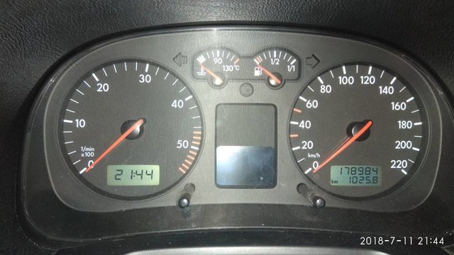

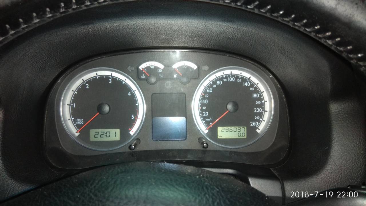

Здравейте.Днес смених най после километража на колата MK4 1.9 TDI AHL 110 Коня.Старото беше такова снимка 1 а новото е снимка 2.Та обучих го изчистих грешките и всичко е точно.Но излиза една грешка за сензор който аз нямам и ако може някой да ми каже как да махна надписа да не ми излиза ще съм много благодарен
VCDS-Lite Version: Release 1.0
Thursday, 19 July 2018, 22:53:51:0
Control Module Part Number: 1J5 920 826 C
Component and/or Version: KOMBI+WEGFAHRSP VDO V13
Software Coding: 01114
Work Shop Code: WSC 00000
Additional Info: WVWZZZ1JZ3D020016 VWZ7Z0B6557792
2 Faults Found:
00562 - Sensor for Oil Level/Temperature (G266)
30-10 - Open or Short to Plus - Intermittent
01336 - Data Bus for Comfort System
49-00 - No Communications

Проблема е решен с прекодиране на таблото по този начин:
Instrument Cluster Soft Coding
?? xxx - Options
+01 = Brakepad Warning active
+02 = Seatbelt Warning active
+04 = Washer Fluid Warning active
+08 = Seatbelt Warning active (NAR only)
+10 = Seatbelt Warning Driver & Passenger active (NAR only)
+16 = Secondary Display (Radio/Navigation) active
Add the values of all the installed options together and the total is the first two digits of the soft coding [;)]
xx ? xx - Country
1 = Europe
2 = USA
3 = Canada/Mexico/Latin America
4 = Great Britain (GB)
5 = Japan
6 = Saudi Arabia
7 = Australia
xxx ? x - Service Intervals
0 = fixed Service Intervals (PR-QG0) without Oil Level/Temperature Sensor
1 = flexible Service Intervals with Oil Level/Temperature Sensor (PR-QG1)
2 = fixed Service Intervals with Oil Level/Temperature Sensor (PR-QG2)
3 = without Service Intervals (USA/Canada)
xxxx ? - Distance Impulse Number (K-Value)
0 = All Engines/Transmissions (Impulse via CAN)
1 = 4345 Impulses/Km or 6991 Impulses/Mi
2 = 3528 Impulses/Km or 5677 Impulses/Mi
3 = 4134 Impulses/Km or 6651 Impulses/Mi
4 = 3648 Impulses/Km or 5870 Impulses/Mi
