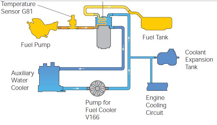

Пак не четеш,казах под фара не между фаровете(радиатора)!Но няма проблем ти си знаеш,ако съм на твое място щях да вържа системата да е постоянно активна че с "охладена" нафта върви повече! :bowdown[/quote]
Не знам сигорно за интеркулера ми говориш, ама той е за вуздух не за нафта mhihi
Fuel Cooling System
The high pressure generated by the pump/
injectors heats up the unused fuel so much
that it must be cooled before it gets back to
the fuel tank.
A fuel cooler is located on the fuel filter.
It cools the returning fuel and thus prevents
excessively hot fuel from entering the fuel
tank and possibly damaging the Sender for
Fuel Gauge G.
Fuel Cooling Circuit
The heated fuel returning from the pump/
injectors flows through the fuel cooler and
its heat transfers to the coolant in the fuel
cooling circuit that also flows through the
fuel cooler.
The auxiliary water cooler reduces the
temperature of the coolant in the fuel
Pump for Fuel Cooler V166 is an electric
recirculation pump. It circulates the coolant
in the fuel cooling circuit through the
auxiliary water cooler and the fuel cooler. It
is switched on by the Diesel Direct Fuel
Injection Engine Control Module J248 via
the Relay for Pump, Fuel Cooling J445 at
a fuel temperature of 158°F (70°C).
The fuel cooling circuit is largely separate
from the engine cooling circuit. This is
necessary because the temperature of the
coolant in the engine cooling circuit is too
high to cool down the fuel when the engine
is at operating temperature.
The fuel cooling circuit is connected to the
engine cooling circuit near the expansion
tank. This enables replenishment of the
coolant for fuel cooling at the coolant
expansion tank. It also allows
compensation for changes in volume due
to temperature fluctuation.

А на моята кола като няма или не съм виждал такъв клапан от кеде се охлажда нафтата по твоята логика.Е..ах разбирачите,не чети ама започни да мислиш малко,а доколото за четенето,за разлика от някой хора не ползвам преводача на гугъл за да прочета нещо[/quote]
Явно не само него не ползваш....... mhihi ама със здраве ;)

Не,не тва е последно че иначе ще кажете че се заяждам!Пак ти казвам за 3-ти път под десния фар,не под левия там е интерколера!
the fuel tank.
Невиждам за какво спорите. Въпреки че и аз си мислех, че излишната нафта се затопля, вместо да се охлажда :roll:

Сега разглеждах и се оказа че не на всички модели има радиатор за нафтата,на приятел със същия пасат има радиатор,после погледнахме още един и се оказа че няма!Много интересно!При голфа ми е друга бира там радиатора се намира под пасажерското място и там излишната нафта винаги се охлажда!
