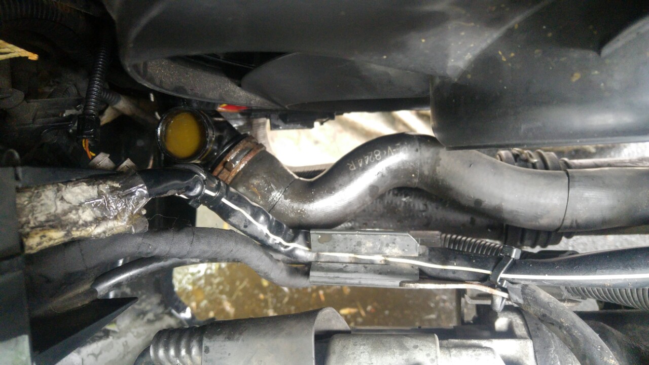

- tdi fen
- Мнения: 4783
- Двигател: TDI AGR
Re: Забива в движение голф 5 1.9 105
ето го, но забиването едва ли е от него

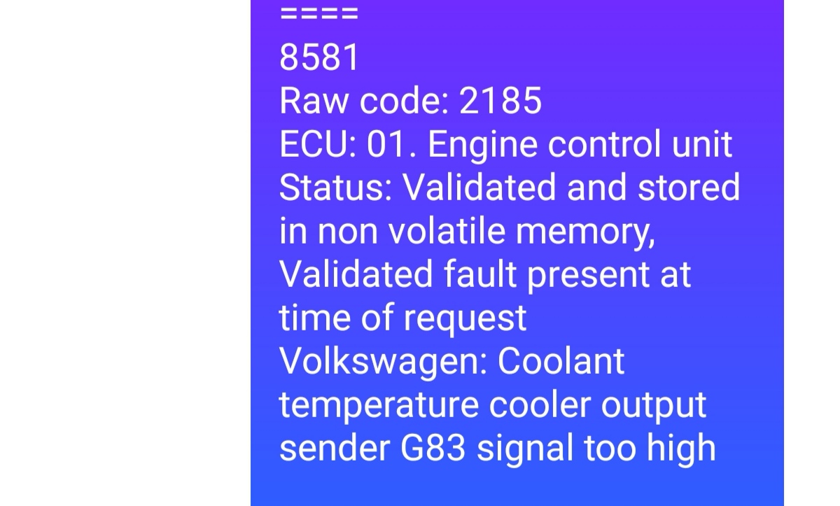

Ето грешките :
Car Scanner ELM OBD2
DTC report
Selected brand: Volkswagen
VIN: WVWZZZ1KZ7W151906
============1==============
1300
Raw code: 0514
ECU: 19. CAN Gateway
Status: Test conditions are met, Validated and stored in non volatile memory, Validated fault present at time of request
Volkswagen: Navigation control unit with CD-ROM drive-J401; Control unit for navigation with CD drive-J401
============2==============
8581
Raw code: 2185
ECU: 01. Engine control unit
Status: Validated and stored in non volatile memory, Validated fault present at time of request
Volkswagen: Coolant temperature cooler output sender G83 signal too high
