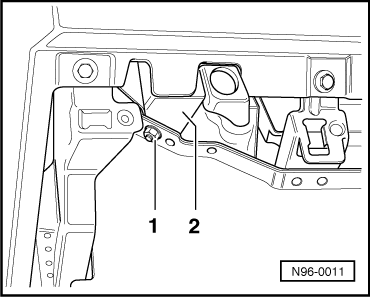

Servicing anti-theft alarm (ATA)
Removing and installing anti-theft alarm system control unit (J 284)
Removing:
‒ Remove drivers' side dash panel trim
‒ Pull 6 pin and 10 pin connectors off anti-theft alarm system control unit (J 284), located behind assembly carrier on left A pillar
Only for vehicles with cruise control system:
‒ Pull 12 pin connector off cruise control system control unit (J 213), located behind assembly carrier on left A pillar
Note:
On vehicles with cruise control system, the anti-theft alarm system control unit (J 284) and the cruise control system control unit (J 213) are secured to the same retaining plate.
‒ → Remove hexagon nut -1-, on assembly carrier, by left A pillar
‒ Pull retaining plate locking lugs out from assembly carrier and pull retaining plate with control unit out from behind assembly carrier
‒ Remove control unit securing bolts from retaining plate
Installing:
Install in reverse order.
shr
Мнения: 68
Регистриран на: Пет 25 май 2007 10:31
Местоположение: гр. Костинброд
Re: Аларма Г3 93-94г. къде е?
Мнениеот shr » Чет 09 фев 2012 10:08
Bioside написа:Там недей да ровиш.Не е аларма.Управлява степените на вентилатора,този който охлажда двигателя и май имаше и нещо за климатика ако имаш фабрично такъв :beer
Removing:
Note:
Installing:
МЕРСИ
