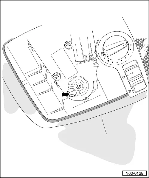

It may be necessary to adjust the zero position if the drive mechanism was not removed in the zero position or the sliding/tilting sunroof was closed or opened by means of the emergency device.
Drive mechanism removed but still connected electrically.
– Select automatic “open sunroof” function on rotary switch.
– Select automatic “close sunroof” function on rotary switch.
– Select automatic “tilt roof” function on rotary switch.
– Install drive in this position (zero position) with sliding/tilting sunroof closed.
From week 32/98, the “zero position” can be seen through an aperture in the motor (markings must align -arrow-).
Накратко - при закачено моторче за буксата с кабелите, но откачено от механизма, се избират последователно:
Отворено, затворено, назад, затворено
и тогава се закача за механизма при положение на люка я затворено положение.

А това малко прозорче за какво в цялата схема?
