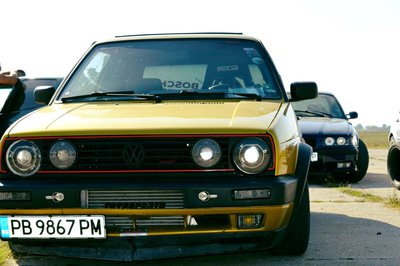

First official run on track, it's dirty but beautiful !
