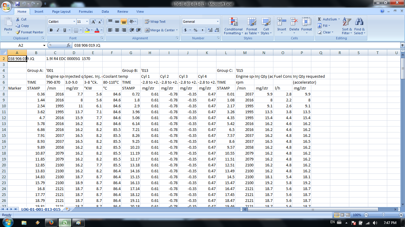

Здравейте! съжелявам за може би глупавия въпрос но някой може ли да ми каже от тези показания дали дюзите работят правилно
Address 01: Engine (038 906 019 JQ)
02:07:04 Group 001: Injected quantity
1575 /min Engine speed 790-870
18.9 mg/str Injected quantity 3.0-9.0
8.2°KW Spec. Inj. duration 3-8 °Ck.
64.8°C Coolant temp 80-110°C
02:07:04 Group 004: Unit Injectors valves command
1596 /min Engine speed 790-870
4.7 °BTDC Spec start of inj. 4BTDC-2ATDC
8.7°KW Spec inj. duration 3-8 °Ck.
2.8°KW Synchro. angle -3..+3°Ck.
02:10:28 Group 001: Injected quantity
2037 /min Engine speed 790-870
29.4 mg/str Injected quantity 3.0-9.0
11.7°KW Spec. Inj. duration 3-8 °Ck.
80.1°C Coolant temp 80-110°C
02:10:28 Group 013: Idle Speed Smooth Running Control
0.61 mg/str Cyl 1 -2.8 to +2.8 mg/H
-0.78 mg/str Cyl 2 -2.8 to +2.8 mg/H
-0.35 mg/str Cyl 3 -2.8 to +2.8 mg/H
0.47 mg/str Cyl 4 -2.8 to +2.8 mg/H
02:10:28 Group 015: Fuel Consumption
2058 /min Engine speed rpm
29.1 mg/str Inj Qty (actual)
8.60 l/h Fuel Consumption
29.1 mg/str Inj Qty requested (accelerator)
